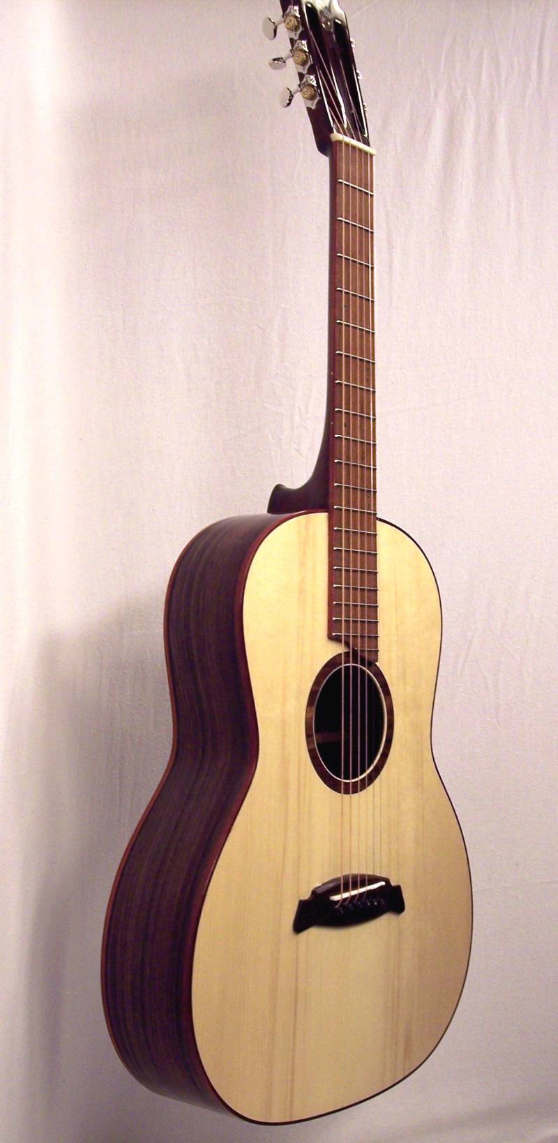

[QUOTE=burbank]Anybody had issues with a Spanish cedar neck on a steel string?[/QUOTE]
I used spanish cedar on this one.   So far, so good......

...and David, that's a real beauty!
